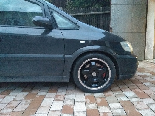

#170 Post autor: michanio91 »

#171 Post autor: Sebu$ »
.... :ok:
Posty: 480
#172 Post autor: Gregor1987 »
:ok:
It’s my birthday
#173 Post autor: janekW67 »
michanio91 pisze: 21 mar 2020, 20:52:f1:
Ładne to! :ok: :piwo:

#174 Post autor: Czesławo Moreno »
Ładne koło :)
#175 Post autor: Wojti »
Nie ma co narzekać :)
